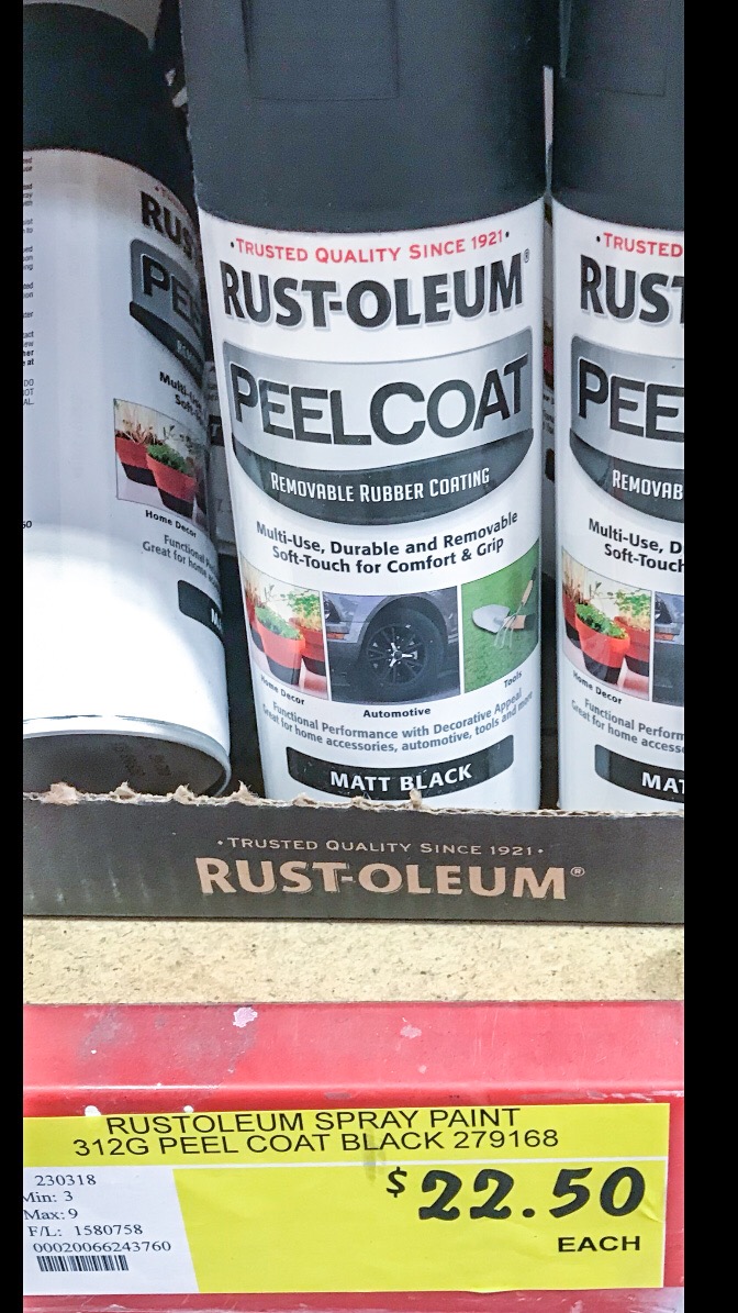

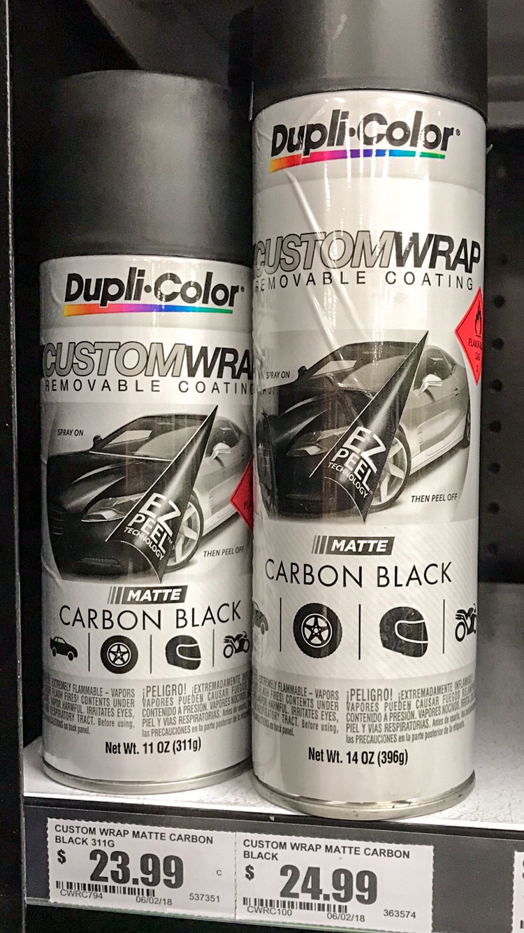

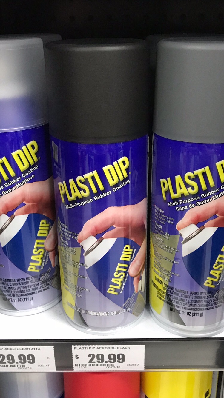

Re: Grill Blackout
I have been investigating options for this and think Plastic Dip option is worth a try.
I have found three different products locally, does anyone have any feedback on benefits or negatives of each?

Re: Grill Blackout
I’ve used dupli colour on my front grille, and on my roof, this is the how the roof ended up(originally matte black but I’ll also show a photo when shiny by being wet/washed)
And
Now I can say the roof has stayed close to perfectly fine for 8 months solid full off hot Aussie summers, rain and all! Also the only way I can fault it is there is a TINYY bit of peeling near my roof diffuser which in turn can be easily fixed.. with the spray you’ll get you’ll end up with a Matt black finish unless you use the dupli Color clear coat/glossifier which I have and been meaning to add to my roof but never ended up getting to it.. for the front of the car on a CJ this should be more then good enough for the job! Just be very careful, spray evenly, take your time and MASSSSK off every bit of your car you do not want to get hit with.
And
We are all in it for the fun!
Re: Grill Blackout
Thanks ReeceCozaa really appreciate the advice, i was leaning towards that.
Will do a trial blacking out my badges first then move to the grill and lower lip section.
What products did you use to clean and prep the area?
2014 Lancer GSR Sportsback CVT 2.4L Silver
- ReeceCozaa
- Lancer Legend
- Posts: 1106
- Joined: Thu Mar 16, 2017 8:01 pm
- Location: Sydney
Re: Grill Blackout
Anything to help mate, for the roof I used old bed sheets to Cover nearly all of the sides, you need to be careful when it comes to spraying with even regular winds as this stuff will fly right onto another panel and you’ll have to rub out all of it if that were to happen.
For the grille you just really need news paper and masking tape, the news paper should cover your bonnet and bumper really securely so you don’t get any miss sprays and the masking tape will be used as a guideline and to obviously hold the news paper down, as for cleaning o honestly just used water and dry wipe, I rushed my grille but it ended up working well, plastidip will honestly go over any surface but if you have any debree and dirt on the grille it’ll show through as bumps, so I would recommend giving it a good clean and making sure the area being sprayed is 120% dry or else it won’t work
