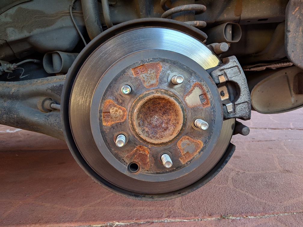

I'm trying to adjust my handbrake to make it tighter. I've pulled out the right rear wheel to find the adjustment hole where I should see a cog to make the adjustments. However when I look inside there are no cogs to be found! At guess at this stage is that the cover has been pulled out previously and they didn't put it back in the original way so that the hole aligns with the cog.
Attached is the photo with the wheel off, let me know if it looks abnormal or I'm doing something wrong.
Thanks!
Tony

The adjuster is at the bottom,get a torch and you will find it.It doesn't matter where the rotor is put on to the hub flange.

lancerdarryl wrote:The adjuster is at the bottom,get a torch and you will find it.It doesn't matter where the rotor is put on to the hub flange.
So if I remove the rubber grommet to expose the hole I should see the a cog somewhere at the bottom? Is it meant to be a cog or another type? What I saw in the hole was a blue horizontal spring and below it is a piece which is some sort of long and silver, but definitely not a cog.
Re: Handbrake Adjustment
Postby lancerdarryl » Thu Aug 09, 2018 9:35 pm
Look at the end of the long silver bit and you will see the teeth

Postby tonee » Thu Aug 09, 2018 9:50 pm
Oh great thanks, I'll have another look.
Just to confirm, down is to tight and up is to loosen and this applies to both sides?

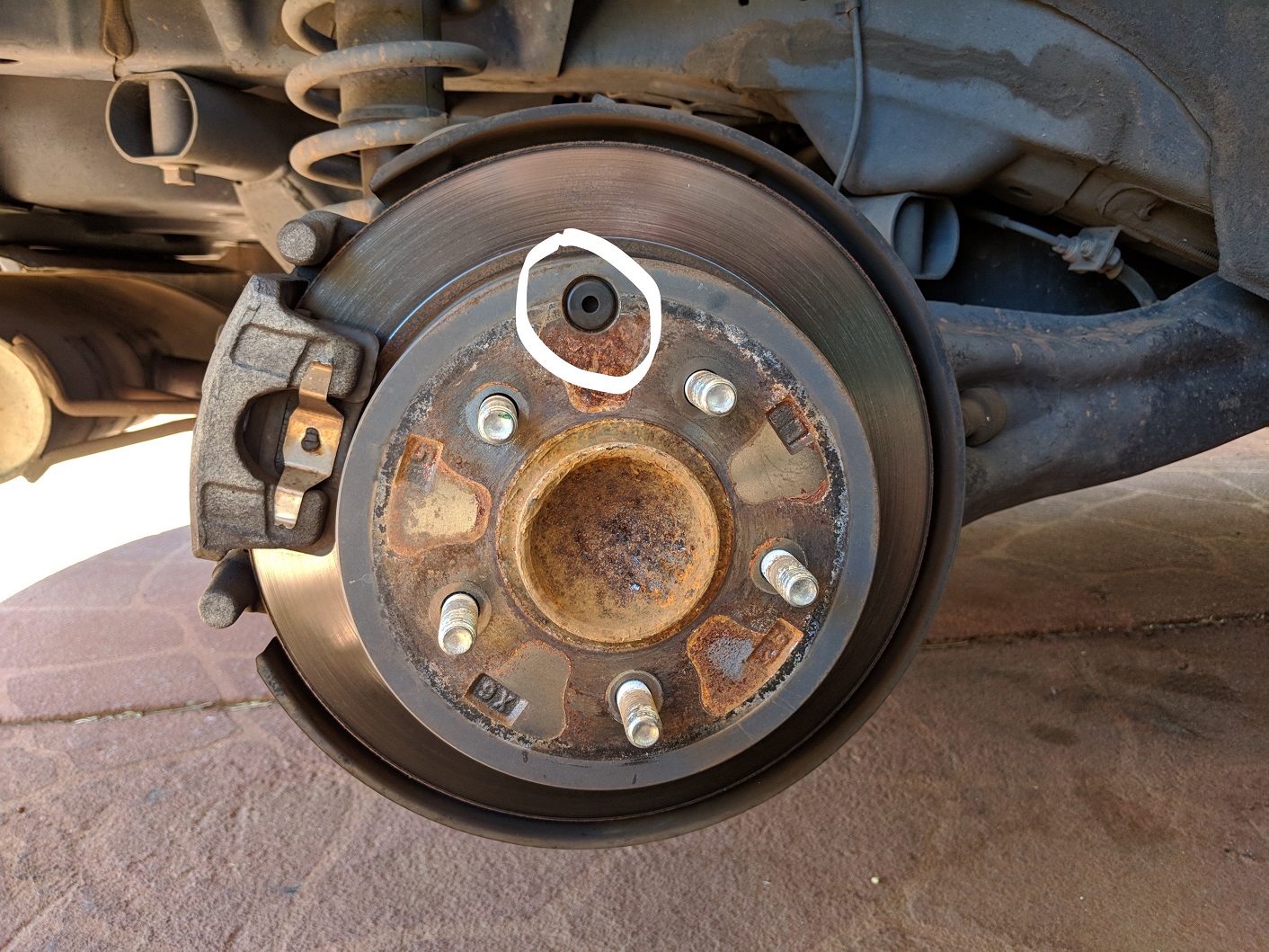

Postby tonee » Mon Aug 13, 2018 10:18 pm
Thanks Darryl I got it all sorted.
For the guys who need to do this this is what I had to do:
1. Remove the rear wheels
2. Remove the small round rubber grommet on the rotor to expose the hole
3. With the handbrake off you need to rotate the rotor until you can find a silver vertical cog (adjuster)
Left wheel: position the hole at 7 O'clock (Refer to attached photo)
Right wheel: position the hole at 5 O'clock
4. Use a flat head to move the cog's teeth. Down is to tighten, Up is to loosen.
5. Tighten and turn the rotor until you feel that it is biting and has friction.
6. Loosen with a few clicks so that the rotor can move freely
7. Don't forget to put back the rubber grommet like I did!

tonee wrote:Thanks Darryl I got it all sorted.
Also judging by the lip on your rotor you might want to replace your rotor if you already haven't.
