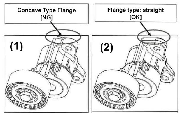

It could be that the flange shears off from the spring sub-assembly... ¯\_(ツ)_/¯MadMax wrote:Anyone got a link to the manual, or a picture of where the tensioner is, or more importantly, which part develops the fatal crack? At one of the bolt holes, I presume?
I'm pretty sure they just check the part number (I presume it's stamped, embossed or labelled on the part somewhere) and replace it with a non-defective part (which has a different part number) where necessary. You may not be able to see signs of potential failure without x-ray equipment - or at all if the defect is internal to the auto tensioner's sub-assemblies.MadMax wrote:Going to look at it at some stage to see if any cracks are visible. If so, put it together and go to the dealer for a free, new tensioner.
It's also definitely worth noting that the inspection should be free of charge...

In this case they check the part number and depending on that and a visual inspection they replace the part. You may need to wait before they can book you in so they have the parts on hand and you don't need to come in again.
And yes its FREE, will only cost you some time. Drop it off for the morning is usually all that is needed. Luckily I work not for from the dealer so dropped it in, and picked it up at lunch.

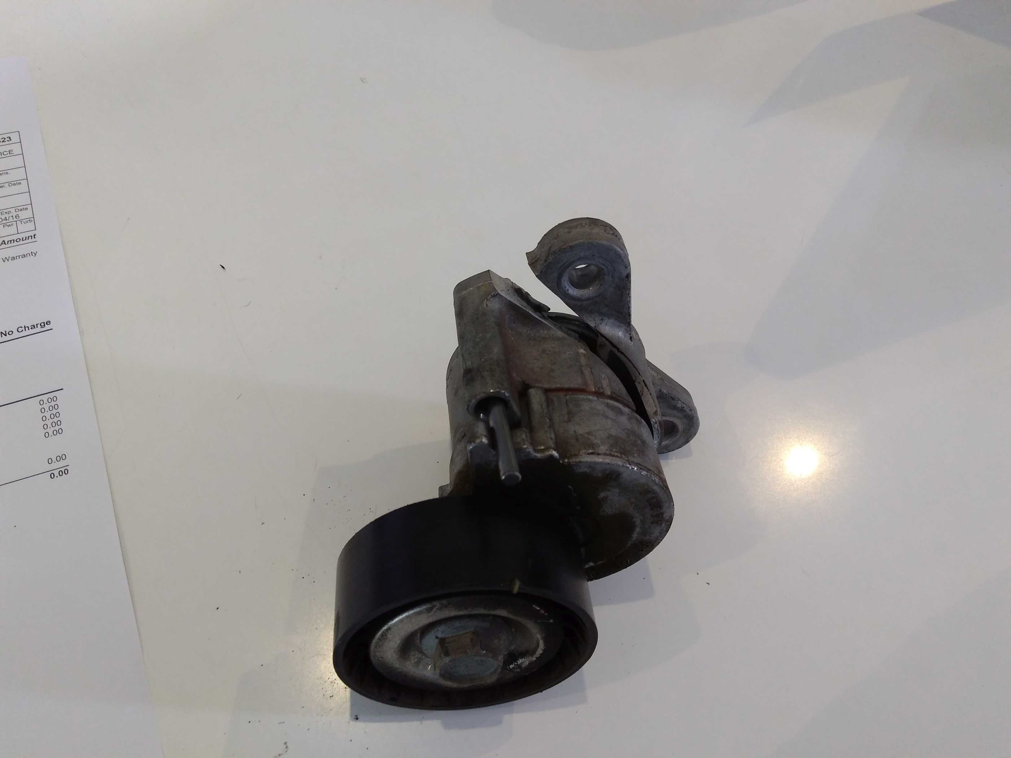

Folks, I took my VH Outlander in for the belt tensioner inspection this morning; prompted by recent belt slippage during engine start and on hard steering whilst parking. Not a moment too soon as shown by the attached photo. The tensioner was already severely cracked. My CJ Lancer will be booked in next.
I've also attached an image showing the new tensioner which has a stronger flange. Access is via right wheel removal and removal of the plastic wheel well splash guard.

Re: Auto Tensioner Flange Recall
Just in time mate
looking at part number 1345A008 fitted to my CJ (which isn't on this current recall but could have been on a previous one) comes up with varying versions of both the good and the bad tensioners, many are still available on Ebay, and even the FEBEST Australia listed one seems to be from the bad bunch. What was the service interval on these parts? were they perhaps pushing them too far?
They probably don't have to but a polite but firm "Could you please check with the mechanic to see what state mine was in etc" usually works. I initially got the story that no replacement was needed until I asked him to check, given I'd had some recent belt slip noise. He came back with "this is one of the first we've seen".
BTW, the car has 80k, with only the last 20k ours.
