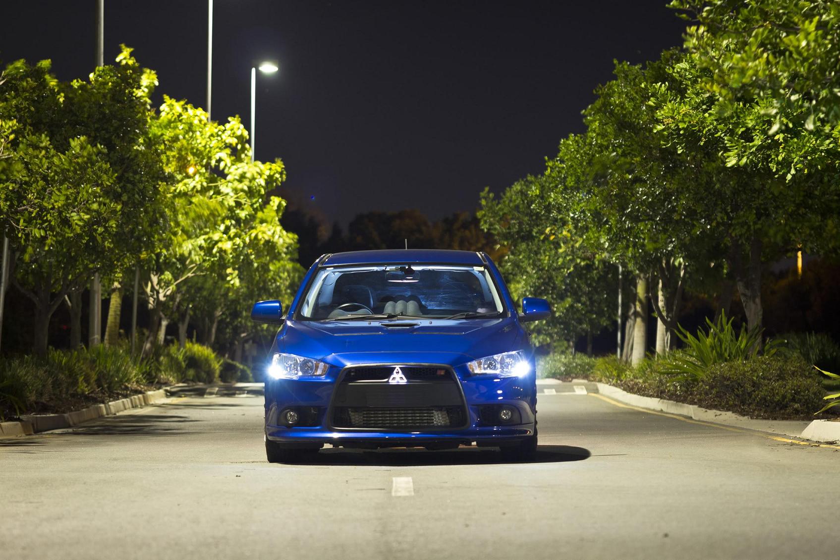

I bought it from another member Meaty.
This one is similar to mine http://www.aliexpress.com/store/product/option-one-car-logo-light-for-Mitsubishi-Lancer-Lioncei-car-badge-lightings-auto-led-light-auto/107398_463017917.html
They also have one with multiple colours http://www.aliexpress.com/product-fm/542281068-option-two-car-logo-light-for-Mitsubishi-Lancer-Lioncei-car-badge-lightings-auto-led-light-auto-wholesalers.html
It is just spliced into the parker light wiring so it comes on with the head lights. There is a basic how to in pictures on their page for the rear one.

zedd82 wrote:Here is my front one
Nice use of light for the photo. I really need to find a nicely lit and diserted carpark to do some shots like this.
Not sure about the illuminated emblems though, but each to their own. I'm sure there are some that don't like the yellow bits on my black VRX.
