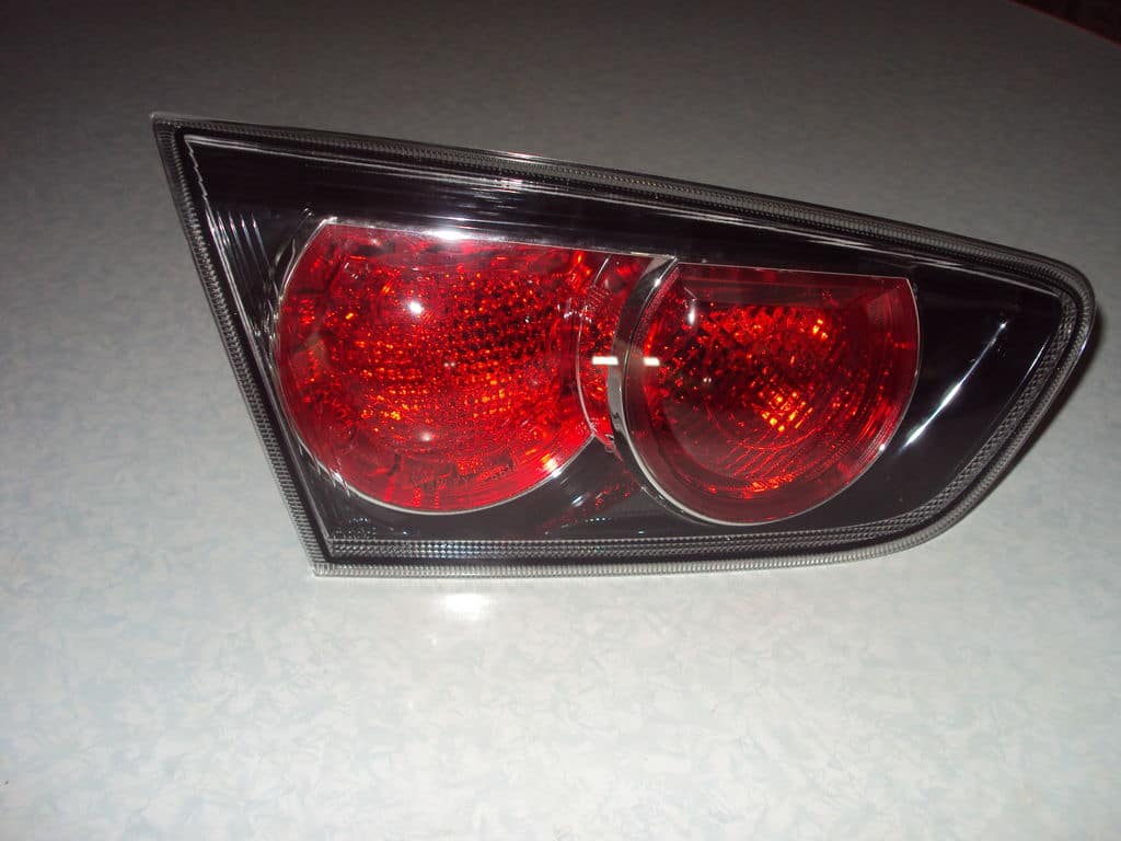

Here is a picture of the euro spec light. only bit that changes is the reverse bit is red instead of white. Part Number is 8337_A087
