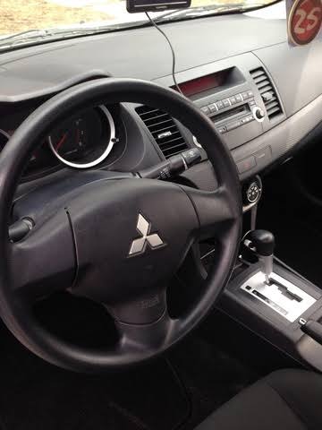

Postby Suspicious_CD » Sun Jan 20, 2019 9:14 am
images (1).jpeg (17.19 KiB) Viewed 24816 times
It's just because that my steering wheel seems to be different to every other that I've seen, it looks something like this
Re: Steering Wheel Control Install
Postby bumblebee » Sun Jan 20, 2019 11:06 am
Left hand model I'm not familiar with.
However the wheel I am curious about.
Out of interest what size motor is yours is it a 1.5 or 1.6 or 1.8 or 2.0 or2.4 litre ?
Postby bumblebee » Sun Jan 20, 2019 1:49 pm
Suspicious_CD wrote:
It's still right hand model it's just the steering wheel is the same. It's a 2.0l
Interesting
The photo sure looks left handed to me when iook at it.
Unless the photo is somehow reversed by magic.
Haven't seen a OEM wheel with nothing on it before like that.
If worst comes to worst you could disconnect the battery for a while and remove the steering wheel all together and replace it.
Or
Have a look at the back of the steering wheel down the bottom there is a small rectangular cover that pops off. Pop it off and see what you can see in it.
