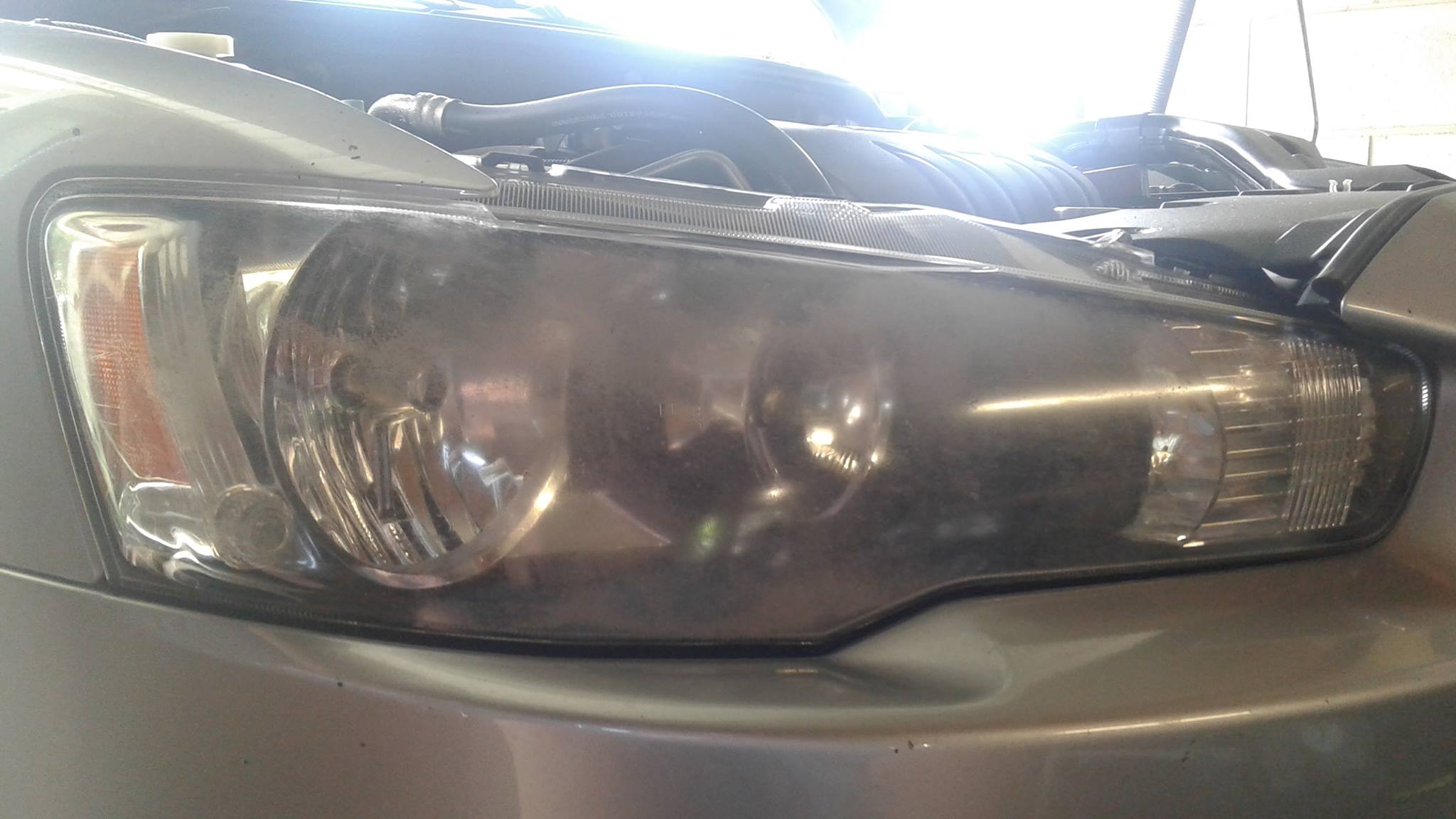

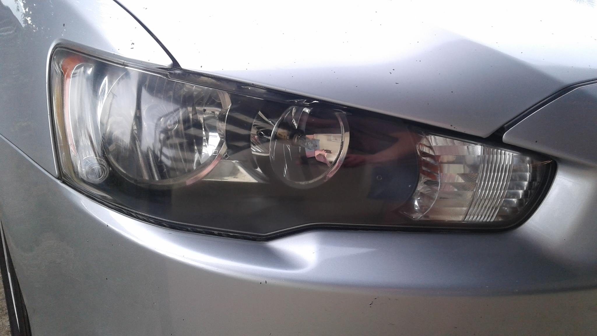

Had a go at fixing the sad looking sun damaged headlights. Came out sweet!

WHATTA difference from old to brand new! The shoots are good could tell it wasn’t a lazy smart phone from the low light shot

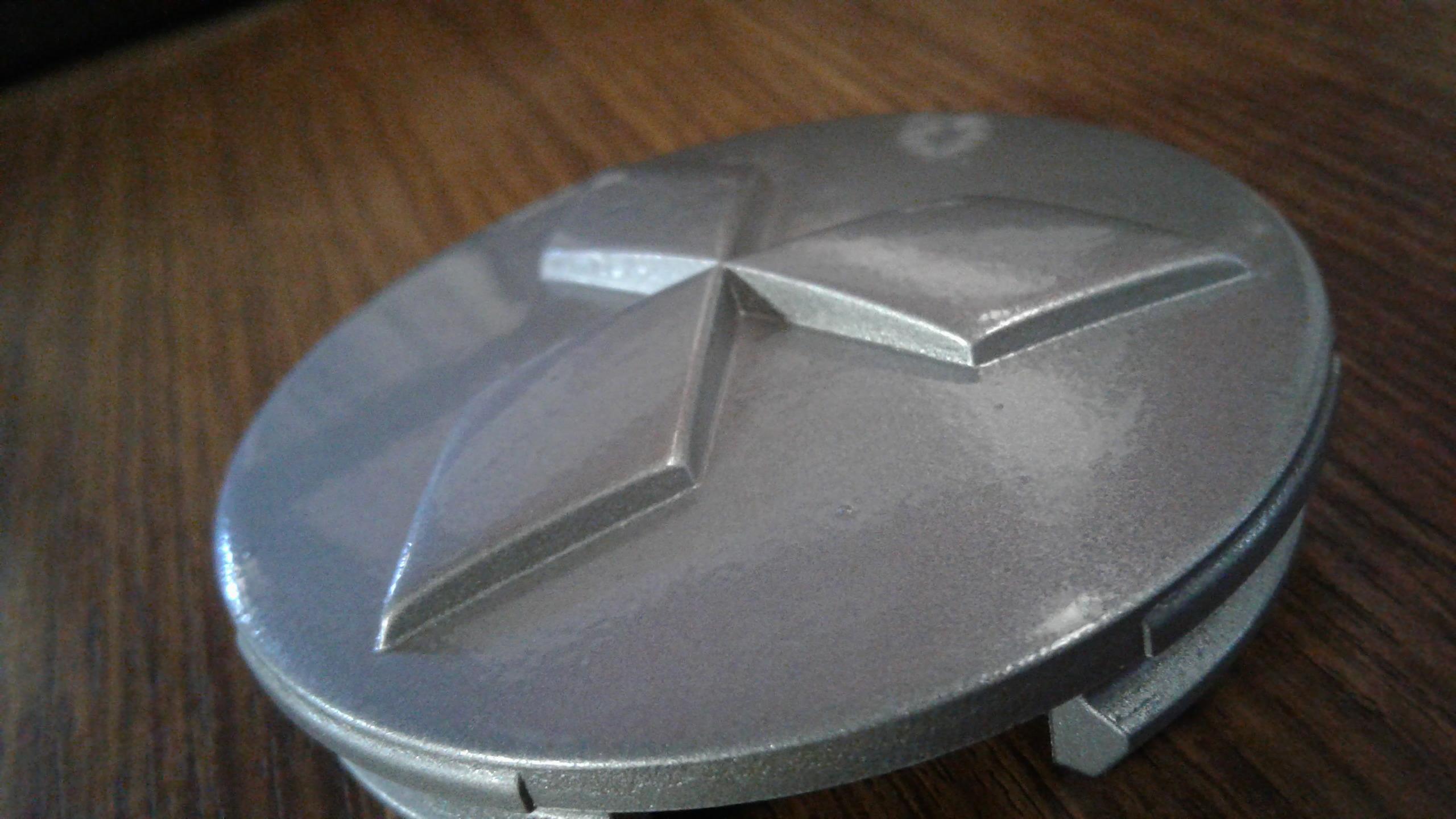

I have really bad OCD when it comes to cars. I have owned nothing but clean cars in the past so a few things on the Lancer have been annoying me! The paint is stuffed all over the top of the car, can't do much about that so fixing everything I can! Having the wing painted soon but gave the wheel centre caps a bit of a sand and paint, slightly different colour but don't notice most of the time. :lolhit:

I've got some slight sun marks on my 09 VRX with stock head lights.
How did you clean them?

Those painted wheel caps look great. Thought about doing mine years ago, but now I've seen yours might have to give it a go!

800grit wet sandpaper, 2000 grit wet sandpaper then polished them with a electric polisher. Did that a few times on them. After the first go just do the 2000 grit wet and polish a few times.
