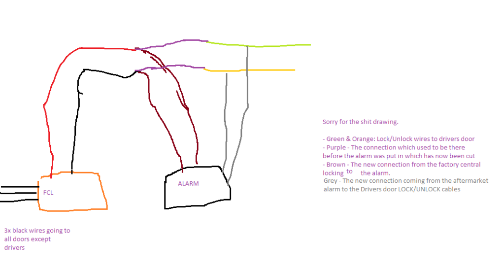

So let me get this straight man, the central locking works if you use the aftermarket alarm and locks all doors correct? and if you use the the oem pad it locks everything except the driver door?
1. why would you install the alarm and use the oem pad in the first place?
2. Im not a alarm fitter or anything but i did a couple of my cars, because no one will install a remote start system before on a manual car. Im guessing what they did was the disabled/cut the main actuator which will be the driver door from the oem central locking. thats why it wouldnt work using the oem pad.

I cant remember for sure but I think a while ago the factory central locking did work when the alarm was disarmed. Ie: The factory central locking worked fine even with the aftermarket alarm. Its a possibility that recently it has stopped working.
Although it would explain a lot if the signal cable from the factory unlock on the drivers door was cut to hook into the aftermarket alarm. Hence when using the factory alarm it will open every door bar the drivers since it was cut and sent to the alarm instead.
I suppose this could also explain why the alarm will only go off when the drivers door is opened and not any others.
I think that might be the reason behind the drivers door not locking, its no longer connected directly to the factory central locking, instead it is running to the alarm. Sound plausible?

the alarm module has 2 wires coming from it, that attach to the lock wire and unlock wire of the factory primary CDL (central door locking) motor in the drivers door - or the same wires inside the drivers kick (should be where they picked them up)
that way when u arm and disarm the car with the python keypad it sends the required trigger down which ever wire it needs to signal the drivers door to lock or unlock. when the drivers door latch throws, it signals the other 3 doors to lock or unlock as required
using the factory keypad will lock or unlock the car, but wont disengage the actual alarm or immobilisor circuits

yes fitter they do it now. but 2 1/2 years ago they wont. now back to your toy michael!
that makes sense to me. all we can do now is trace all the wires from the alam to which wires the jb guy connected it with. fitter is im not mistaken its the blue/red, blue/black wires are the arm disarm door locks from the cdl, and its the brown and green for the after market one. if we could trace this tadz i think we'll know whats going on. if it was cut from the CDL or not. If it was it will explain a lot,
but then just realising it now all the wires from the other doors will be connected to the CDL right? so if the driver side door was cut there will be no connection between the driver door and the passenger doors.
Unless the jb guy did what i did when i fried the CDL of the lancer? i hooked up all the arm / disarm wiring straight thru the new alarm module. tadz did you check your fuses?! i remember popping 2 boxes of em while doing my alarm. it could be as small as that?
let us know. if you'll need a hand to remove all the electrical tape (assuming the jb guy wrapped it or heat shrunk the wires), uve got my number just message me.

So what your saying fitter is basicly this....
Fitter
Club Vendor
Club Vendor
Posts: 1288
Postby Fitter » Thu Jan 05, 2012 6:24 pm
on the 12 pin harness, 2 wires, Purple wire, Green wire.
just get tapped straight on. no cutting, no bypass, just tapped straight on and soldered

With the drawing, thats the only reason I can come up with as to why the factory central locking will only work on the 3 other doors and not the drivers. I understand they should of just tapped it, but maybe they didnt...
Hense whenever the drivers door is unlocked with the alarm key it unlocks all the other doors because the drivers door latch as been triggered...
