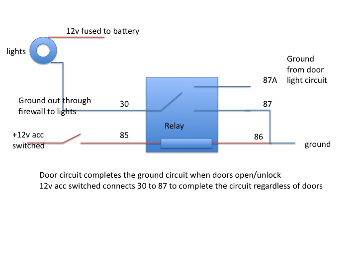

Ya that's how I wired my grill led strip. Just wasn't sure if I could also add on the angel eyes in the same way. I'm gonna have to give it a try on the weekend but i think I've got a solution. I'm going to wire in the angel eyes to the dome light and the parklight with a relay to switch between one and the other.
So when the relay coil isn't charged pin 30 and 87A will be connected which will be the dome light powering the angel eyes giving the fade effect and unlock function. When triggered, pin 30 and 87 will be connected which will be the parking light circuit and since 87a wont be connected there shouldn't be any feedback to the dome light. The trigger, pin 85, will be the same source as pin 87, the parklight +.
So when the parklights turn on the power to the angle eyes should switch from dome light to parklight. Only thing to test is if the domelight circuit can power the angel eyes. I'll take some pics this weekend and post up a how to or how not to do depending on how I go.

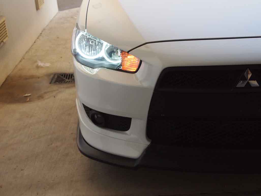

K got my angel eyes in the mail and went by jaycar and picked up some 5 pin relays wired it up to the dome light circuit and instead of the park lights I wired it up to cigarette adapter with a built in switch. Open the doors and the angel eyes came on. Door closed they faded out. Turned on the cigarette switch, relay clicked over and angel eyes came on. Turned on/off all the map/dome lights, lights stayed on.
Now I just gotta take the front off, bake the lights and wire it up for good.
I'll take some pics and draw up a wiring diagram to better explain it
Glenn wrote:K got my angel eyes in the mail and went by jaycar and picked up some 5 pin relays wired it up to the dome light circuit and instead of the park lights I wired it up to cigarette adapter with a built in switch. Open the doors and the angel eyes came on. Door closed they faded out. Turned on the cigarette switch, relay clicked over and angel eyes came on. Turned on/off all the map/dome lights, lights stayed on.

so if i were to follow this wiring diagram, but instead of the switch, have that wired to the parkers,
would the angel eyes fade on/off with the door and also be on whenever the parkers are on?

klvru wrote:I want to do it in a way then if my lights are on, and when i unlock the car it will turn it on and lock it will off. However when the light switch is off, when i unlock the car, i dont want anything to happen.
Wow that's confusing.
stumped me.
Do you want it so if the car is on acc or engine on, you can then lock/unlock to control the AE's or do you mean if you left the car off with the lights on next time you go to unlock the car they come on?
i dont know how it (this relay system) could "know" whether you left the lights on or off. I think that would involve the ecu which probably is best left alone.
you could wire up like my diagram but put in a extra switch from the door ground to the relay to act as a master switch. If that was off then it wouldnt light up with the unlock.
You'd have to though know that the next time you lock/unlock your car you didn't want the angel lights to come on. kinda takes away from the automatic part of it in my opinion.
