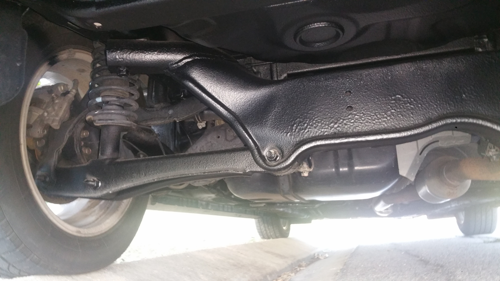

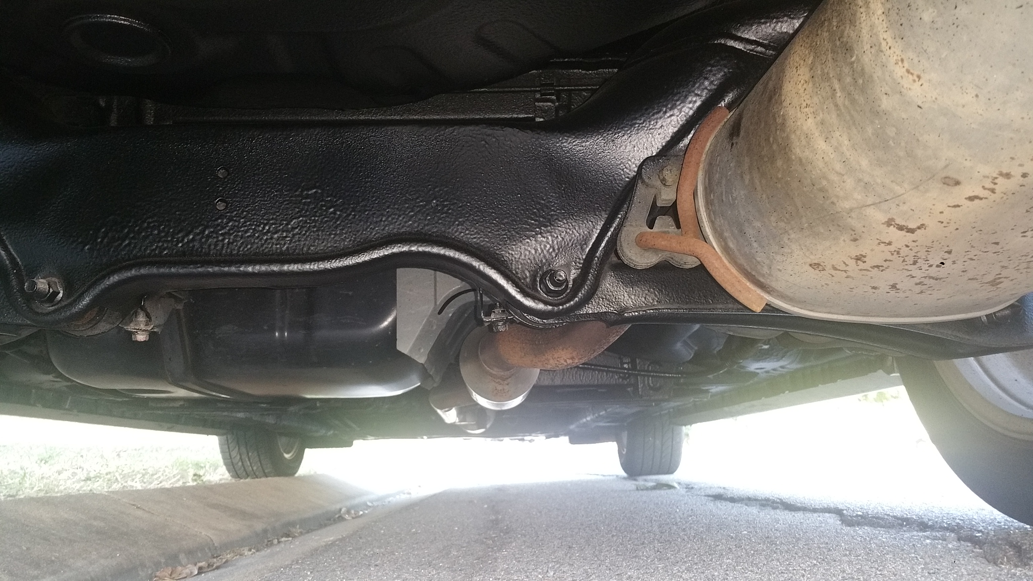

ITEM: 18mm OEM rear swaybar and lower control arms, including endlinks and mounting bushes with saddle clamps.
LOCATION: Melbourne, Victoria (Templestowe).
ITEM CONDITION: Used, was removed from a wrecked 2008 ES at Jollys U Pull it in Dandenong.
Details see: http://www.jollysupullit.com.au/eziparts/Display_Vehicle.asp?PriceListID=0&VehicleID=529891&Location=jollysupullitcomau&LocationID=2003&VehicleDesc=Mitsubishi%20CX/CY
REASON FOR SELLING: Removed as few opportunities to get OEM swaybars from DIY wreckers.
PRICE AND PAYMENT CONDITIONS: $130 cash only, or best offer.
SHIPPING AND POSTAL ARRANGEMENTS: Pick up only, or happy to deliver in person anywhere in Victoria.
EXTRA INFO: A great upgrade for any 2012 or later car as they don't come with one as standard. Also a starting point to add aftermarket bars (Whiteline etc.) easily for cars that have none.

Im no expert on suspension. But are they the bushes in the arms in the photo that is shown by Moonman in this thread?
How many kilometers do the bushes usually last before they give up the ghost?

bumblebee wrote:The bushes that are spoken of in this thread that got replaced from Siberian bushes
viewtopic.php?f=72&t=19335&p=395279&hilit=Siberian#p395279
As an example I did the same swaybar conversion on my own car with bushes from 2010 with 160,000km on them, I've done around 40-50k more and the bushes are still in good condition, no perishing or movement. The bushes in the arms that I sold had done 69,707km so should last a fair while longer.
Of course with anything there are outliers and variance but if in doubt the bushes from your current arms can be a substitute.
Poly bushes I personally don't think are much use in the back as the arms are clamped solidly by the sub frame and wheel spindle each end so are subjected to little backwards forwards movement, but that is just opinion not an expert assessment.
