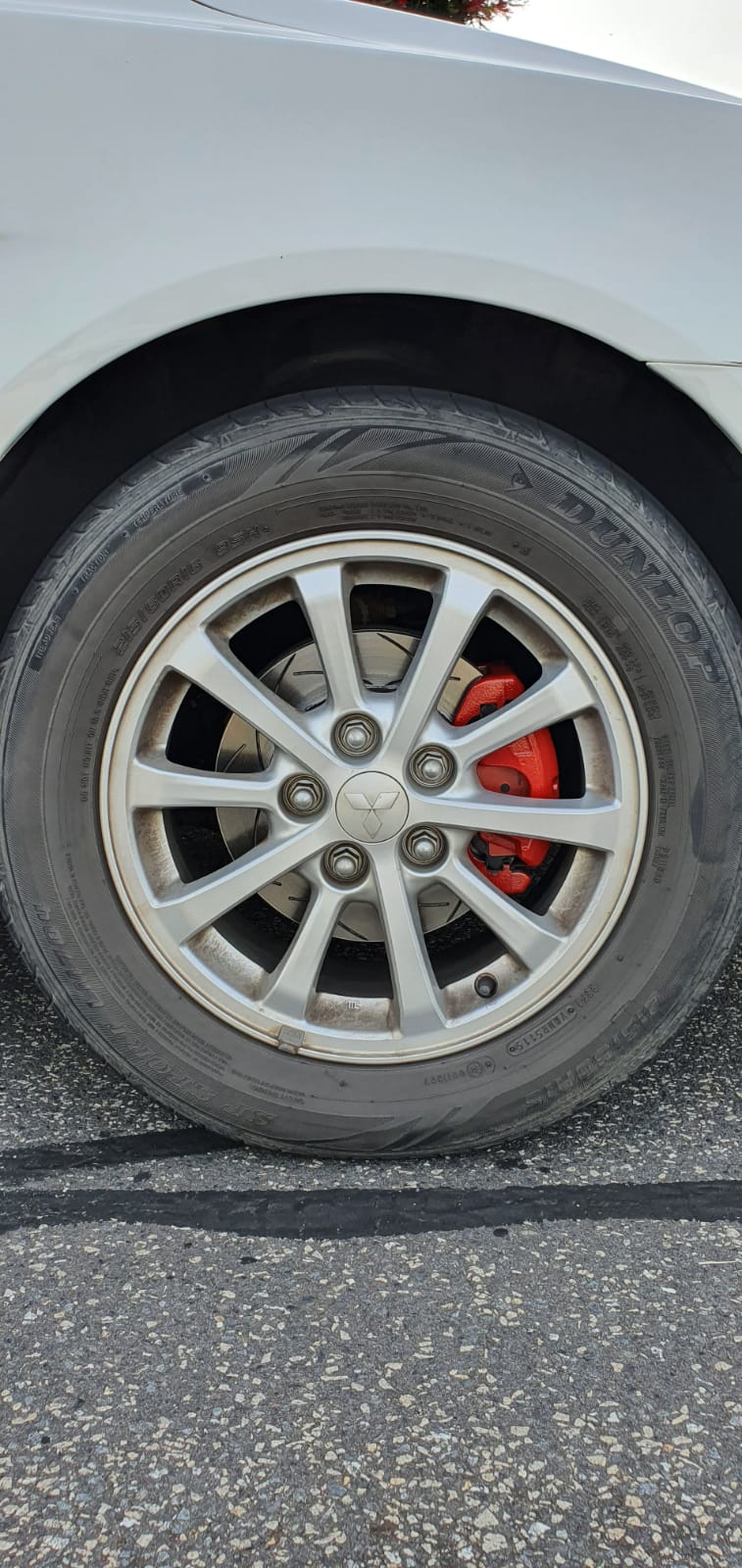

Hey Guys! Sorry this reply is quite late but I just finished up installing a new set of brake pads and rotors. I ditched the lines (for now) but in my opinion, they look gooood!
So, a recap on what parts I've used -
DBA T2 Rotors for front and rear and Brembo brake pads for both front and rear and I also threw in paint on the calipers just for aesthetic gains :lol:
Anyway guys, thank you all for your suggestions.

Postby bumblebee » Fri Oct 23, 2020 6:06 am
What paint did you use on the calipers?
MysteryGuy2107
Posts: 53
Joined: Wed May 13, 2020 12:19 am
Re: Regarding the whole braking setup
Postby MysteryGuy2107 » Tue Nov 10, 2020 9:10 am
https://www.supercheapauto.com.au/p/dup ... lsrc=aw.ds
This is the link of the paint which I used. Its from Duplicolor saying that this paint is specifically for painting brake calipers and so far despite having brake dust and all, when I washed it with Meguiar's ultimate wheel cleaner, the brake dust came out easily while not scraping the paint off.
