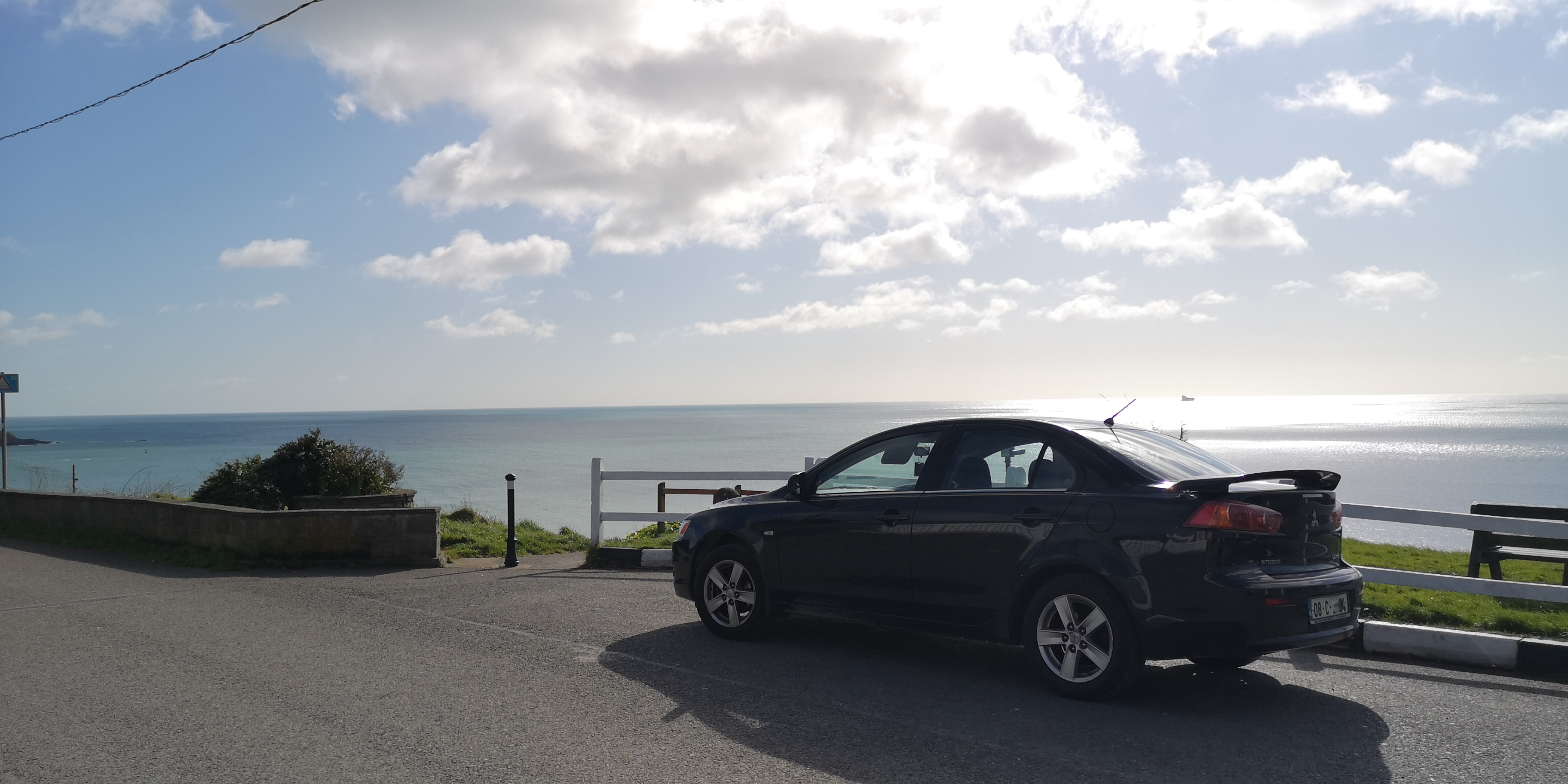

Postby Lancer08 » Mon Mar 09, 2020 9:29 pm
Pretty but problematic.
