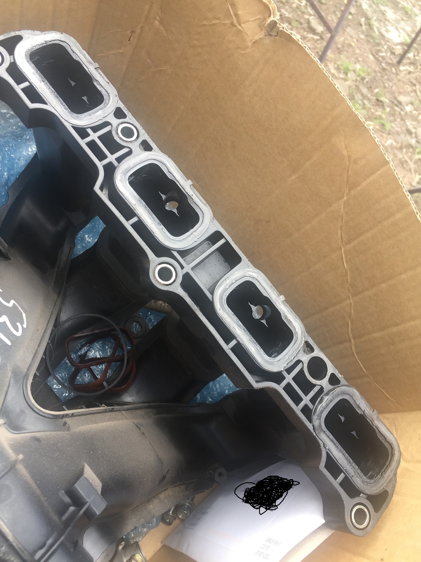

Here's a photo of the removed manifold and gaskets.

So am hoping that this will cure the CEL. All in all it should.
