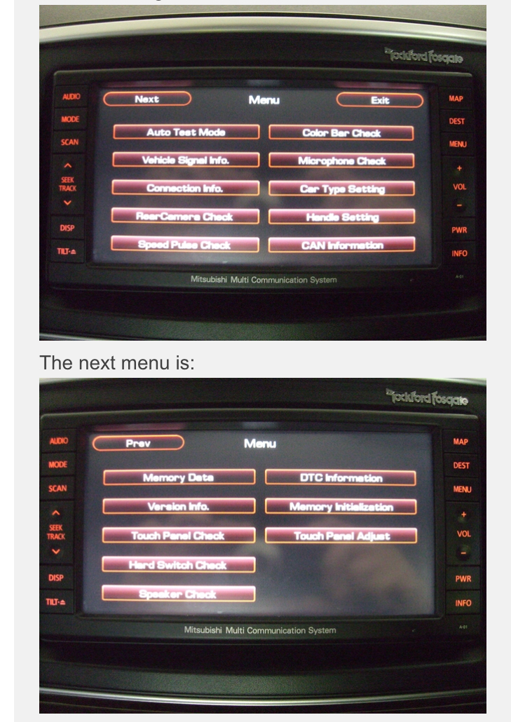

Hi guys and girls. Wondering if anyone has a old working MMCS version 1 unit they would like to sell ?
- Attachments
- 23C77582-06DC-475D-BC79-81C40B4D6821.jpeg (798.97 KiB) Viewed 46262 times

I believe that’s the version we have which isn’t allowing access to the menus because of faulty touchscreen and unsure if other models are compatible mate

I have an A-02 unit in my MY09 VRX. It's touch calibration is dodgy at the best of times. So much so, that I haven't yet been able to get into the service menu. I also don't know if it is the original unit. There is some stuff that doesn't seem to work, e.g. Variable & Rain Sensitive wiper control (although this could be something else). The SAT NAV is ok, but expensive to keep updated and doesn't include traffic, speed cameras, etc. and voice control is a little long-winded in execution. Bluetooth phone is rudimentary and not voice operable. They do play DVDs and CDs, but audio sources are limited with no default USB (apparently some models had a USB box in the glovebox), some very early iPod stuff (some iPhones work too) but require a special cable (with a 9-pin mini-DIN or similar connector and sometimes a spliced power connection so it doesn't go flat), and no Bluetooth streaming (although can add a Bluetooth to RCA converter)...

We can’t get touchscreen past the initial startup screen as the accept icon won’t respond to touch so we can manually tune radio and manual volume access only. Very frustrating as I bought the model with the Rockford Fosgate setup so the son could boom boom shake the room lol. It’s his car to drive. The first week the accept icon actually worked, but on the bottom left hand side the settings icon for audio controls wouldn’t respond. A new battery was fitted to car and then after that the MMCS system rebooted from CD and we can’t access any ice bs

I should mention my short-term plan is probably to disassemble and then clean the touch digitiser connectors with isopropyl alcohol before reassembling and testing. My touch problem seems to be temperature dependent, and I'll have moments where it seems to work fine... I did see a new digitiser on e-bay for $125 (from China), but I also read somewhere that the digitiser cannot be separated from the LCD panel, so I don't know if that is a workable solution (I haven't personally verified that claim). The issue really is whether the root cause is confined to the digitiser and relevant connectors or whether the problem extends into the control circuitry on the main board.

Thanks Ben and Moo. Actually late the other night when it was cool the son said that he actually got into the menu but the next morning it was not letting him again and hasn’t since. We do have a very big self serve wreckers close by and probably 100 others within a 20k radius. I will ring around tomorrow and see if I have any luck Moo. Also Ben I would be very interested if you get a chance to clean the sensor and it brings any luck. I’m not as technical as you but I have built a few PCs in the past and might be able to follow your lead. Thanks again for your support and thoughts on this pesky problem I’m having

The effect of temperature could be several things, from de-lamination of the digitizer panel or cable (presuming it is a flexible PCB ribbon type), to misalignment or corrosion of the digitizer cable connector(s), or it could be a general overheating of the digitizer circuitry (the units have a fan which likely needs maintenance). Or it could be a combination of all or some of these items or something else...
I've really only used freeze spray to check for dry solder joints on PCBs, thermal cut-offs (to reset them during testing) and to free up seized bolts or other interference (pressed) fittings. I'm not sure how an LCD or digitizer would hold up to a quick freeze. It would depend on the thermal ratings, but most parts are not designed to operate below 0℃ or change temperature quickly (ΔT is typically low)...
Will post what I find when I tear mine down and clean it up...
