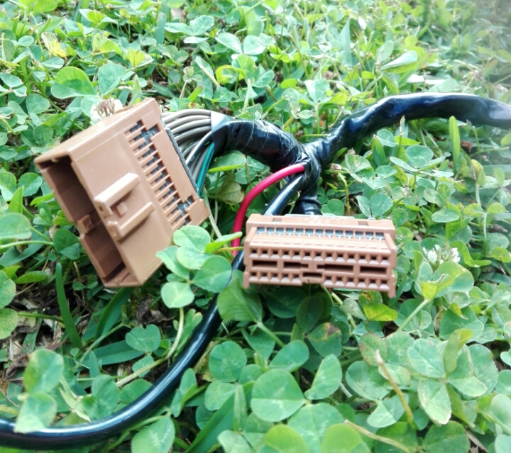

I have bought an OEM towbar and wiring kit from an auto wreckers. I've attached the towbar but I can't find where the wiring harness should plug in. It's supposed to be a plug and play kit but not sure where the plugs are hidden in the boot area.
Any help would be appreciated!
(2012 Lancer sportback)

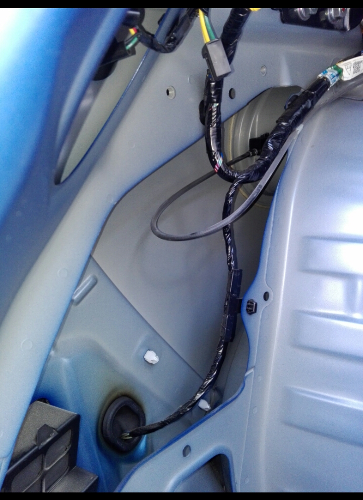

I've removed the left boot trims but there's no plugs that fit the same as the wiring harness. Do I need to remove the rear bumper bar to access it?
This is a photo of the wiring harness and the wires just behind the rear left wheel arch

It has a grommet to run it outside, just not caught in the photo. I called a towbar shop and they seemed to think I'd have to remove one of the seats to access the plug. Does that sound right?

That reminds me there is a LOT of wiring on the left side over the wheel arch, but to access it you need to remove the bottom part of the back seat, then unbolt the side bolster on the left. I don't remember if there were any plugs and yes it would be a weird place to put on for a tow bar lighting harness.

I did find about 3 plugs along the wheel arch under a panel. One of them turned off the left indicator when unplugged but the wiring I've been supplied with doesn't fit in that plug. Maybe I have been sent the incorrect wiring harness?
