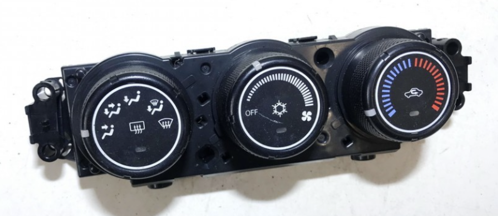

This is the climate control cluster I am talking about by the way
Does anyone have any idea what I should check? I'll provide updates along the way as I find them.

EDIT: The climate control instrument cluster is now working and operational again. I didn't do anything except leave my car parked outside on a 35 degree (Celsius) day for about 6 hours which to my understanding would have dried any moisture trapped in what I believe was an electrical harness causing it to short. It was nice seeing the climate control working so I could use the AC again. Anyway, lesson learnt here is probably to not put the foam directly into the AC vents. Instead, it might be better to put it into the drain tube from underneath the Lancer (jack or hoist required however).
