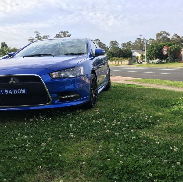

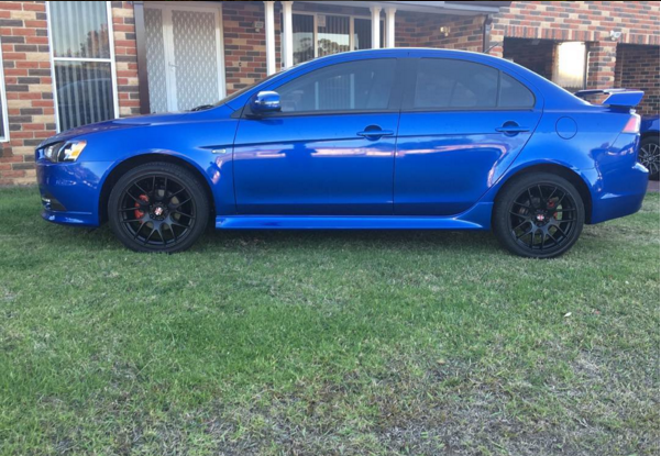

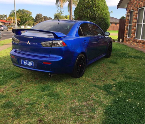

Hey guys im new to this and I have had my es lancer for a year now i have done the usual rim mods but I think that it is time to step it up a bit but i have no clue where to start lol

Thanks all for the opinions, yer was looking at getting a cat back system put in and as for cosmetics I was wondering if anyone knew where I could get a RA Bonnet that is a direct bolt on and was wondering do I need to get a whole new front bumper if I was to move my front numder plate to sit under the headlights?
