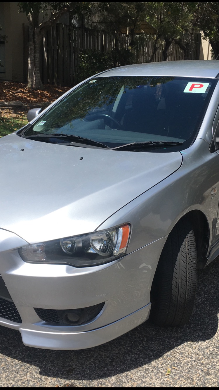

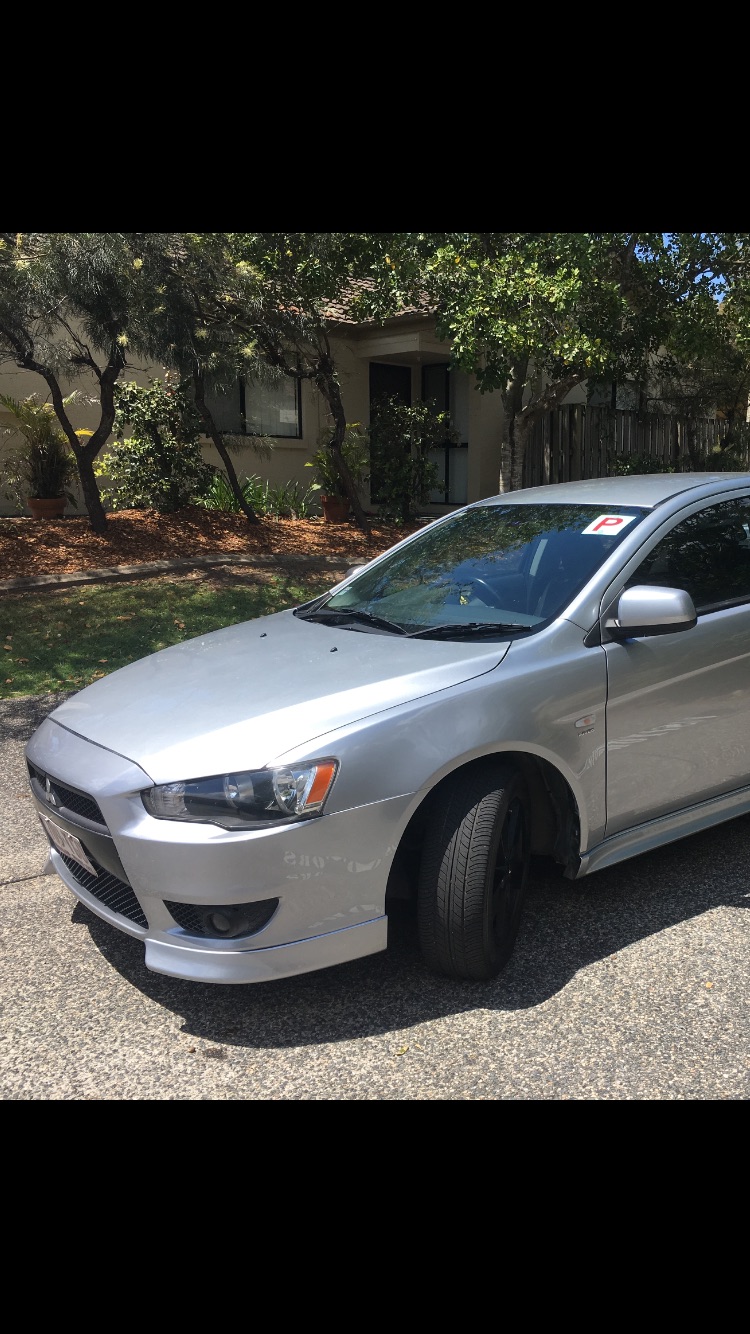

Hey so these pictures are my front apron lips installed, primed and painted. These are the fibreglass ones and you can see the fitting is not 100%. It's nothing too obvious, but you can definitely tell close up. Fibreglass also has a tendency to crack if it has impact or anything like that, so when you park front first, make sure you are careful when park and kerb bumps. Looking at Stevie's pictures, the plastic ones do look really nice, so I think that if you're not too fussed about the more expensive plastic option, I'd definitely go for those. But if you don't mind the small gap between the bumper and lip on the fibreglass option, it is the cheaper alternative.

- IMG_2652.JPG (270.33 KiB) Viewed 37761 times
- IMG_2651.JPG (298.18 KiB) Viewed 37761 times
Re: Installing VRX Front Apron Lip
They look nice! Obviously there is a gap. You can always user a filler to hide it a little more.
