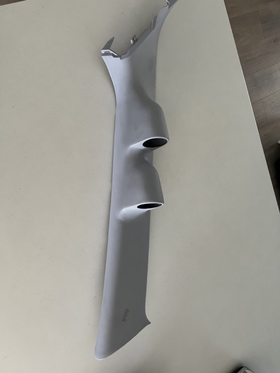

I originally purchased a ortiz custom pod for two gauges that sit on the pillar. Very well made but I was disappointed with how the pillar sat. it had too much weight with one gauge in it and kept hanging down. That's why I went with the carbon panel. I'll post a picture of the pillar tonight when I get home from work.

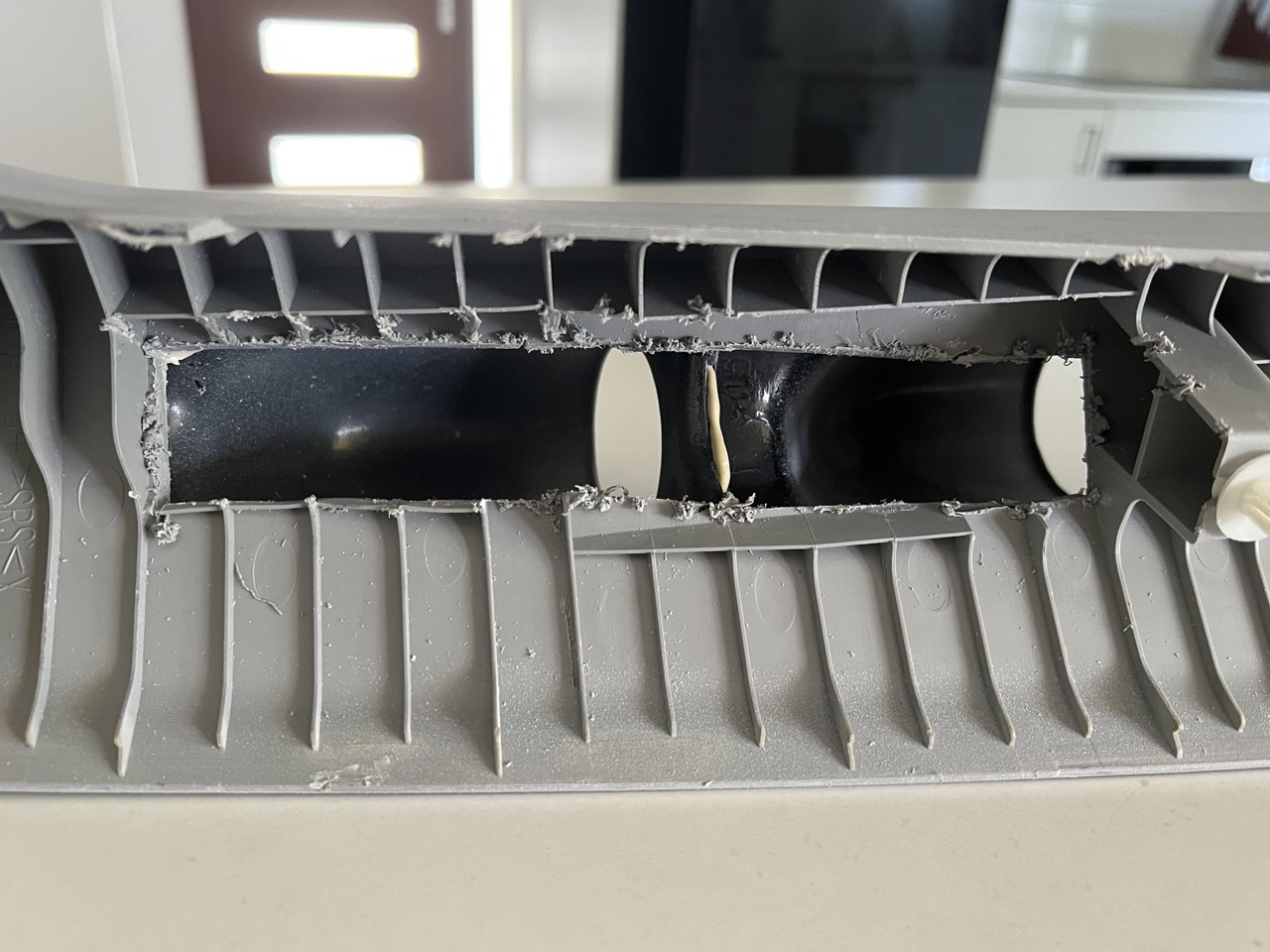

I finally got around to taking a couple of pics of the Ortiz custom pod 2 gauge pillar pod. It's really well done, just has a design flaw in not being able to keep gauges and locked in tight against the windscreen etc.
I had to trim a fair bit of material from behind the pods to allow wires to be run
