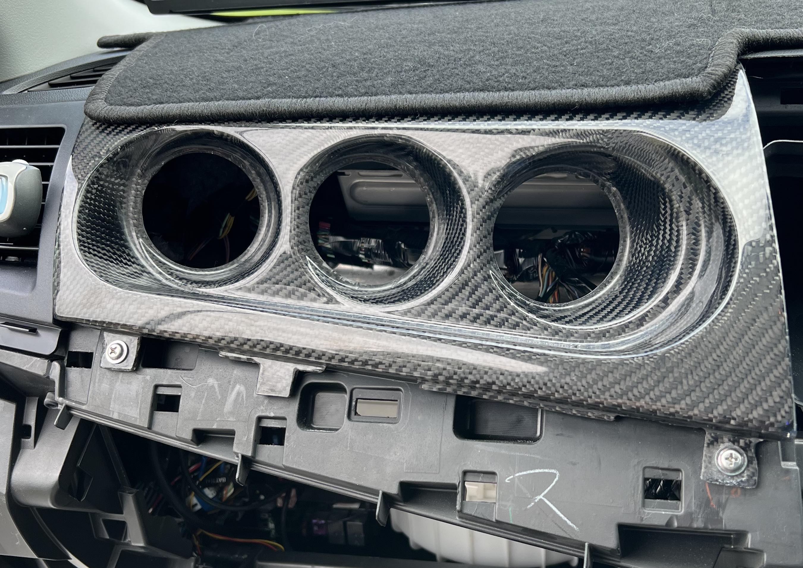

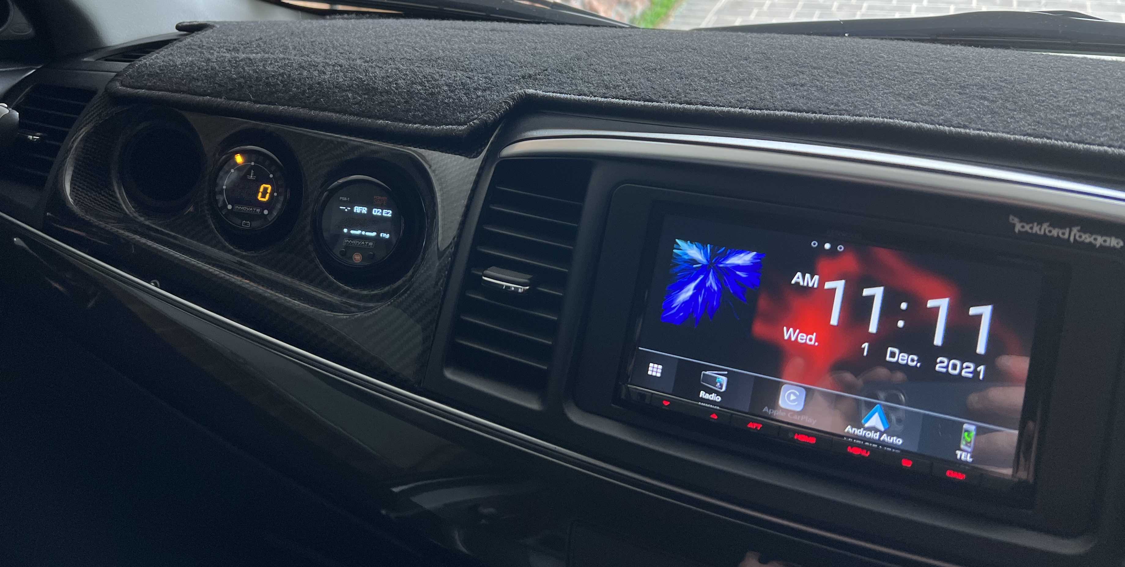

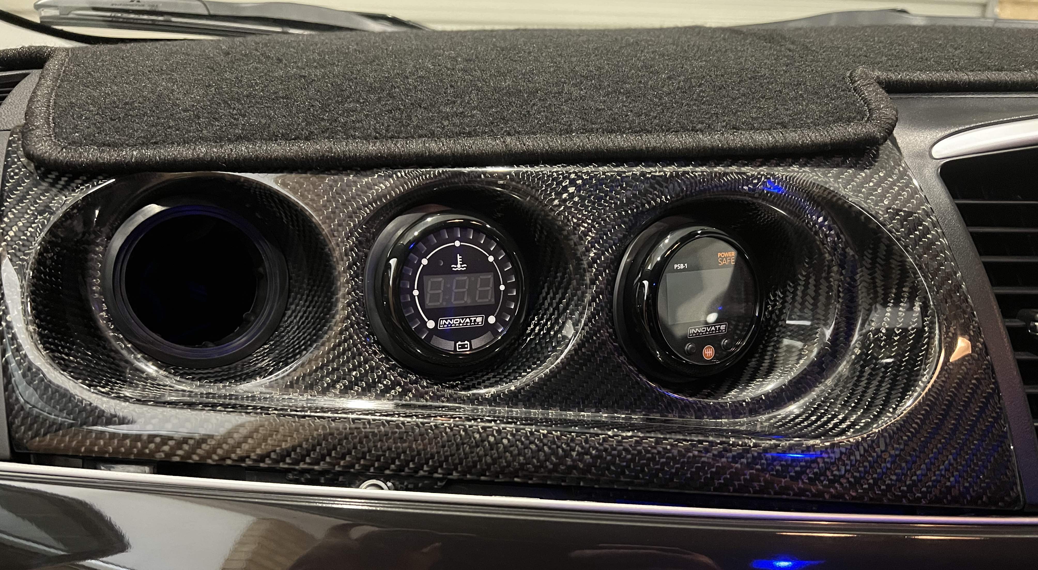

I am getting ready for my flex tune in Feb with Benchmark. I have partially installed 2 x Innovate gauges. 1 x Powersafe Boost Air/Fuel Ratio gauge and 1 x Water Temperature & Battery Gauge. I still have to hook up the wideband o2 sensor the bung was really tight on the exhaust so I need to heat it up to loosen it at my stepdad's workshop. The water temp isn't working yet as I need to get something sorted to either wire into the stock sensor which I have heard can cause issues or get a fitting to use the spare spot on the thermostat and install the sensor that came with the gauge in there. The spare spot will house the e85 gauge to be installed by Benchmark. I ended up having to get a gauge holder from Aliexpress. The brand name ones are all discontinued. I actually missed out on buying a Blitz one by about a week from a place in the U.S. Fitment of the holder was not too bad. There is a little gap at the bottom I complained about they said they won't do anything about it. I'll just get some black foam tape. After the panel in-dash was removed I had to cut out quite a heap of it for the cluster and gauges to fit. Overall looks pretty good I think.

Is the airbag a problem?

Nah its in the panel below. it comes out through the top of dash mat

That setup actually looks REALLY clean, great job! as opposed to the pillar clusters which are also pretty cool. Good luck on the install adam.

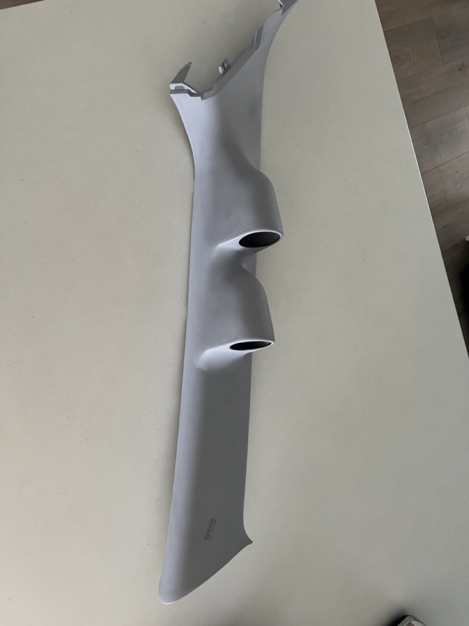

I originally purchased a ortiz custom pod for two gauges that sit on the pillar. Very well made but I was disappointed with how the pillar sat. it had too much weight with one gauge in it and kept hanging down. That's why I went with the carbon panel. I'll post a picture of the pillar tonight when I get home from work.

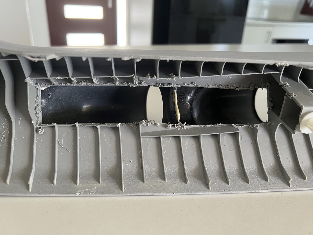

I finally got around to taking a couple of pics of the Ortiz custom pod 2 gauge pillar pod. It's really well done, just has a design flaw in not being able to keep gauges and locked in tight against the windscreen etc.
I had to trim a fair bit of material from behind the pods to allow wires to be run
