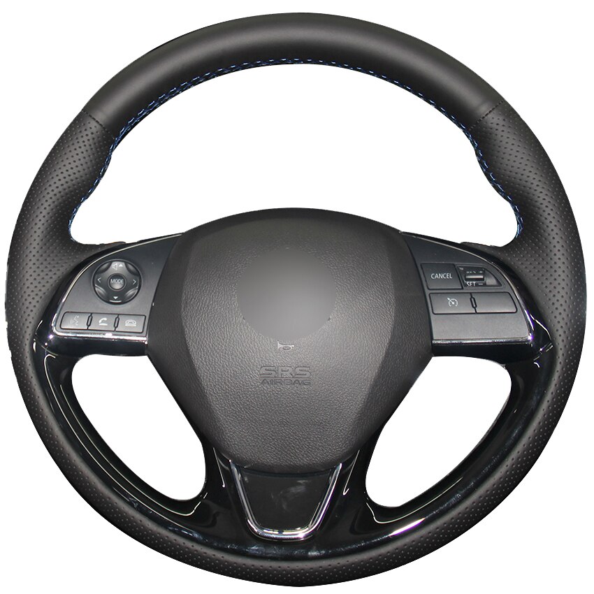

Re: Steering Wheel removal
Postby bumblebee » Thu Aug 15, 2019 3:30 pm
This is the Mitsubishi Triton steering wheel I want.
A mate of mine bought his a few weeks ago .
Sadly he won't let me pull it to bits to do a test fit
