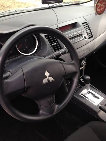

images (1).jpeg (17.19 KiB) Viewed 25359 times
It's just because that my steering wheel seems to be different to every other that I've seen, it looks something like this

Left hand model I'm not familiar with.
However the wheel I am curious about.
Out of interest what size motor is yours is it a 1.5 or 1.6 or 1.8 or 2.0 or2.4 litre ?
Thanks

Suspicious_CD wrote:
It's still right hand model it's just the steering wheel is the same. It's a 2.0l
Interesting
The photo sure looks left handed to me when iook at it.
Unless the photo is somehow reversed by magic.
Haven't seen a OEM wheel with nothing on it before like that.
If worst comes to worst you could disconnect the battery for a while and remove the steering wheel all together and replace it.
Or
Have a look at the back of the steering wheel down the bottom there is a small rectangular cover that pops off. Pop it off and see what you can see in it.
