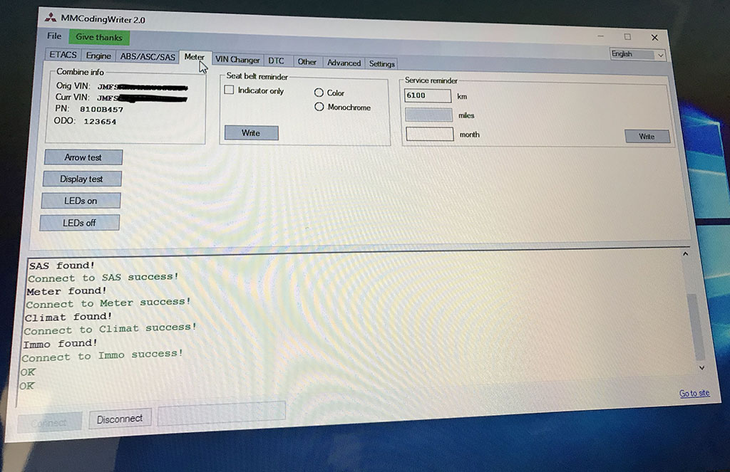

Here's an example of a VIN mismatch where a CY sportback cluster was placed in a CX sedan. I don't know if its gonna cause any issues but it is visible if a dealer does any diagnostics on the cluster.

Handy info
Thanks for that
If it was going to cause any issues mine would have done it a few years ago

I installed windows 10 and tried out MMCodingWriter 2.0 connected it up and had a look at the Section to do with the cluster, Mine doesnt have an option to change the odometer value. Does this only come up when there is a different vin number? I'm checking it out as I want to get a colour dash for my wifes car and want the odometer value spot on. I tried this on my car (Evo X).
Also on different note how do you change the ETACS stuff within MMCoding Writer?

I have used ETACS decoder but don't like how they have changed to a more subscription based program. Do you have the older versions of MMCoding I might try it and see if it allows odometer change. Someone asked the exact question on the Facebook forum for MMCoding and the answer was no. So maybe it only works with new odometers.

Yes i have been told that this option cannot be changed
I would be very interested to see if any older versions of MMcoding will let u change the Odometer settings

MMCodingWriter have never do this.
