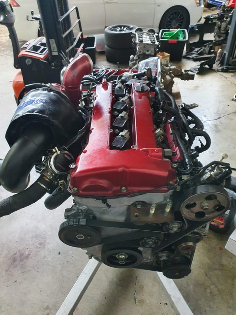

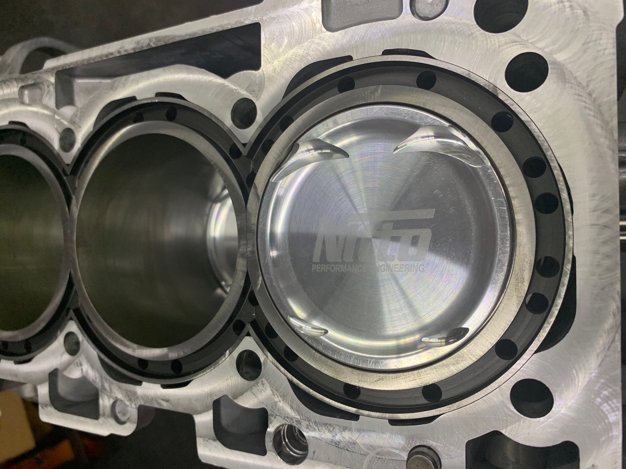

UPDATE! (Belated)
New engine/turbo set up is in!
As it sits now is as follows
Head
GCS Manganese valve guides
GCS Valve stem seals
Super Tech Inconel Exhaust valves
Super Tech Black Nitrate Intake valves
Ferrea Titanium retainers
Kelford valve springs
AMS TMP Cams
AMS Billet Cam Cap
ARP 2000 cam studs
Driven Fabrication Billet Exhaust MIVEC housing
Ported intake and exhaust
Flow tested
Block
Nitto 2.2lt stroker 88mm 9.2:1 pistons
ARP CA625 rod bolts
Darton MID sleeves
ARP CA625 Head studs
ARP 2000 main studs
MAP Billet timing guide
Custom Oil cooler
Raceworks braided oil lines
Cosmetic 88mm head gasket
Torque solutions front engine mount
Torque solutions rear mount
Engine bay accessories
Carbon bonnet struts
Carbon fuse box covers
EXD firewall heat shield
EXD mivec sensor heat shield
EXD cam and turbo outlet heat shield
EXD tubular manifold heat deflector
EXD coil cover
Weapon R coolant tank
Weapon R power steering reservoir
EXD 3 piece Aluminium undertray
EXD oil cooler
Mishimoto Radiator
Mishimoto Thermostat
Mishimoto Thermo Fans
Turbo/Exhaust
Custom CRG high mount manifold
BW EFR 7670 T4
Twin Turbosmart 40mm waste gates
Custom CRG 3.5” dump pipe
Custom CRG 3.5” Cat back
Intake/Intercooler
Custom 3.5” intake with heat shield
6” K&N dry pod filter
Upper and lower hard piping
Race works 2.5” pipe coupler
TS compact BOV
PWR intercooler
Driven Fab air/oil separator 10an
Race works braided lines and fittings
Fuel
Oem lift pump
Raceworks surge tank
Walbro 460
Easy controller fuel controller
Walbro 255 hard wired
Twin 6an raceworks braided feed lines
Works fuel rail
ID1700 injectors
TS 1200 FPR
Blue Flex flex sensor
Body
Custom blood red candy respray with gloss black roof
Ralliart carbon lip
Rex speed carbon nose piece
Carbon bonnet vents
Varis carbon pillar panels
Carbon side skirt extensions
Varis style carbon diffuser
Carbon exhaust shrouds
Black Hawk Limitless 2.0
Head lights
Retrofitted Depo projectors
Evo-XR bixenon projectors
Demon eyes
Switch back 3/4 halos
RGB half moon halos
Suspension/Wheels/brakes
MCA Reds coil overs 11kg/12kg
Work D11r 18x10.5+22 matte bronze discs matte black barrels
Work emotion flat black/chrome center caps
MCA real nuts
OEM Ralliart front strut brace
OEM Ralliart rear strut brace
DBA t3 front rotors
DBA t2 rear rotors
Carbon front air guides
HEL braided brake lines
Drive train
MAP E9 CMC upgrade with braided clutch line
DCS twin plate ceramic
ACT monoloc
Radium Engineering Clutch fork stopper
Torque solutions shifter bushings
Torque solutions shifter base mounts
COBB short shifter
White line rear diff bushes
Interior
Redline leather steering wheel retrim
Redline leather gear boot
Redline leather console retrim
Android head unit
AEM wide band
AEM boost gauge
AEM oil pressure gauge
EXD fire extinguisher bracket
Ortiz twin dash pod
Custom ash tray gauge pod
Alpine Halo9 head unit

Technically with the over bore as will it now has a capacity of 2.3lt. I wouldn’t go any further over bore then 88mm though as there has been reports of lots of head gaskets leaking due to not enough sealing area etc. the build was only completed in early 2020, final tune done in September 2020. Due to the fact I work away this last year has been much harder with border closures and not being able to get home to work on the car or put kms on the engine for run in. So again due to time constraints I haven’t run it at willow bank, though I’m more interested in sprint racing then drag racing. Hopefully will be out in the street sprints series this year.
