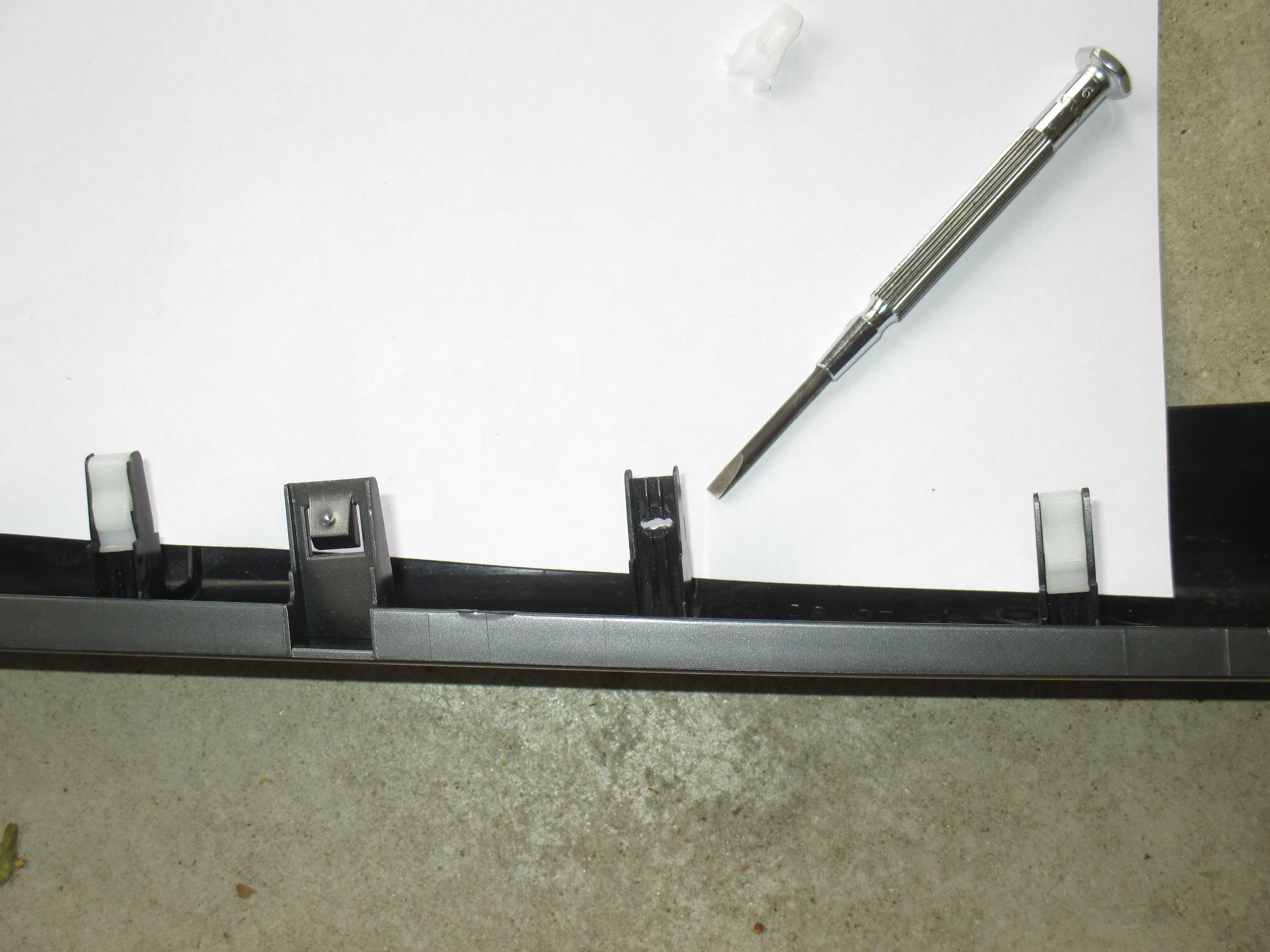

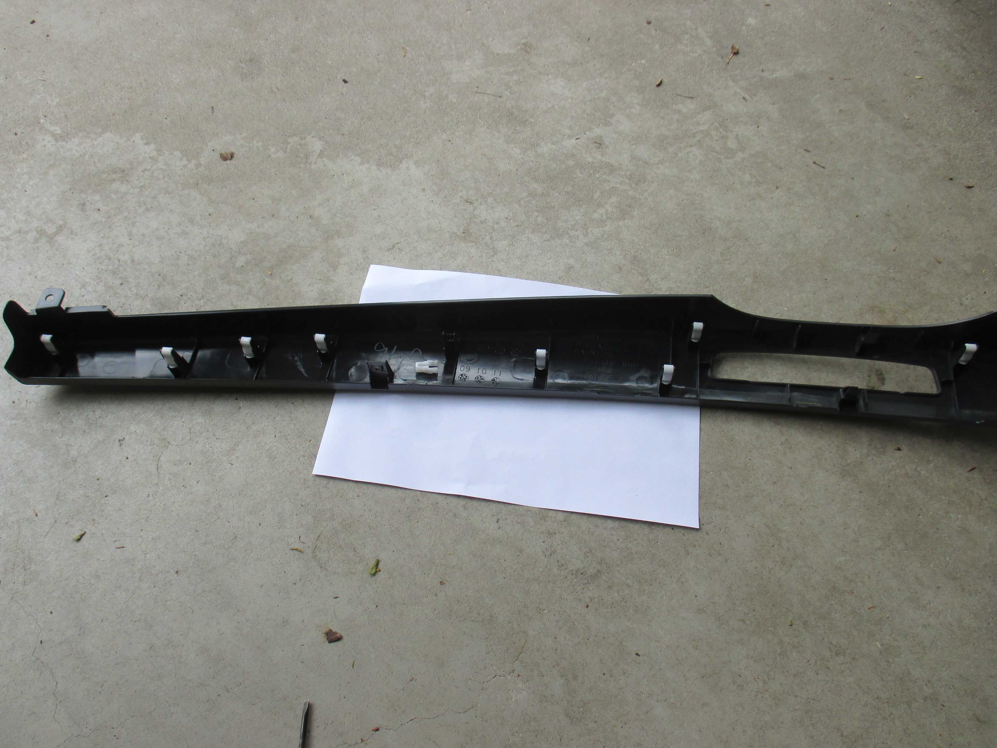

I've a 20111 manual CJ sedan and have what I would describe as a resonant buzzing at revs between 2000 and 2500 rpm. It appears to be independent of gear. Suspect causes have been the heat shields in the engine bay (over the manifold and against the firewall) and the dash, but to date I have not traced the cause.
It may be of use to some to note that the plastic garnish around the passenger light and hazard switch was missing two white nylon clips from new. The attached photos shows the garnish and one of the mounting posts, with an irregular slot highlighted by a paper background. Two posts had no such slots and I had to drill them out to fit the missing clips. In my case at least, the buzzing is still apparent with the garnish removed.
I welcome anyone who can identify the source of the buzzing.

by Skrallex
Yeah my VRX was missing those when I pulled it apart for the first time too (though I am second owner). Did you manage to get some clips? I had to contact mitsubishi, I have the part number if you wanted to get some.
Re: Hello Guys, Have a rattle in my dashboard
Posted: Sat Aug 13, 2016 1:06 pm
by Falcoon
Yes thanks. Mitsubishi supplied them free of charge as the car is still under warranty. I should have, but did not get the part number, so it would be worth listing for reference if you have it.
BTW, on the posts whereyour clips were missing, were the slots missing?
Posted: Sat Aug 13, 2016 4:42 pm
by Skrallex
Slots didn't seem to be missing for me. See this thread for item part number.
