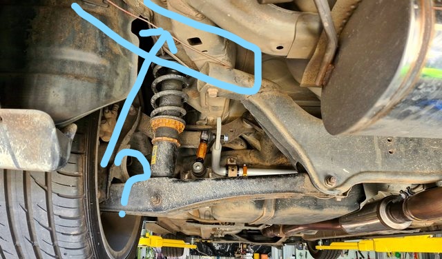

ave wire.jpg (983.68 KiB) Viewed 1124379 times
Ave' , what's this random wire do?
Avenir
Posts: 146
Joined: Sat Sep 12, 2020 6:44 pm
Location: Victoria
Re: 2008 Lancer CJ VRX - Build thread
Postby Avenir » Sat Jan 22, 2022 2:47 pm
I believe that might hold some of the wheel guards?? It's all factory. It's too far past the brakes to be the handbrake cable.
Lancerdarryl might know??
Postby lancerdarryl » Sat Jan 22, 2022 3:42 pm
Does it have a tow bar? The ecu for the trailer plug has a power wire from the battery running to it.It is supposed to be inside the vehicle.Apart from that I don’t know it isn’t there from factory.
